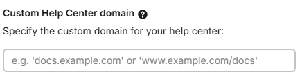

Have anyone successfully created a custom subpath for the Help Center?
I would like to make my Help Center available on our main domain www.oursite.com/help, but despite every setting, it only shows “Not found” error message.

  1. Check Articles: Ensure you have at least one published article in Articles > All Articles.
  2. Verify Intercom Settings: Go to Settings > Help Center > Domains, add www.oursite.com/help, and click Save and Set Live.
  3. Configure DNS/CDN: Set a CNAME record (www → custom.intercom.help) and route the subpath (/help) to Intercom via your CDN (e.g., Cloudflare Page Rules). Ensure SSL is set to “Full.”
  4. Test: Clear your cache and visit www.oursite.com/help.
Could you confirm if you have published articles and your DNS provider?
Adding a CNAME for www pointing to Intercom will override the entire site, not just the /help subpath. This is clearly not the solution.
I spent some time reading into this for you Simon.. You can only reliably set up a custom subpath for your Intercom Help Center using AWS CloudFront or a similar CDN with path-based routing. Cloudflare does not support this for most users. The "Not found" error is due to missing or incorrect routing for the subpath. For most setups, Intercom recommends using a subdomain instead.
