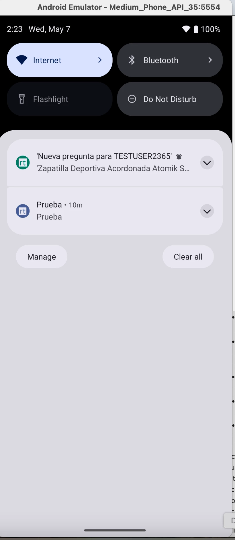

We were able to setup Intercom using @intercom/intercom-react-native library on iOS and Android, but we’ve some questions for Android push notifications.
We added the drawable icon and it’s being used but the icon used in the notification is different. Is there a way to change it? Do you know why Intercom’s notifications are not grouped with the notifications of my application?

Hello,
We're using @intercom/intercom-react-native 6.8.1, and although we were able to set the icon correctly, there's no way to change the background color. I've been searching for documentation and reading your code, but I don't see any method or instructions for doing this. Could you tell me if there is a way?
I'd like to clarify that we have FCM configured correctly, and our notifications appear with the correct background color.
I've attached proof: the green notification is ours; the gray one is Intercom's (it takes the system default color).
