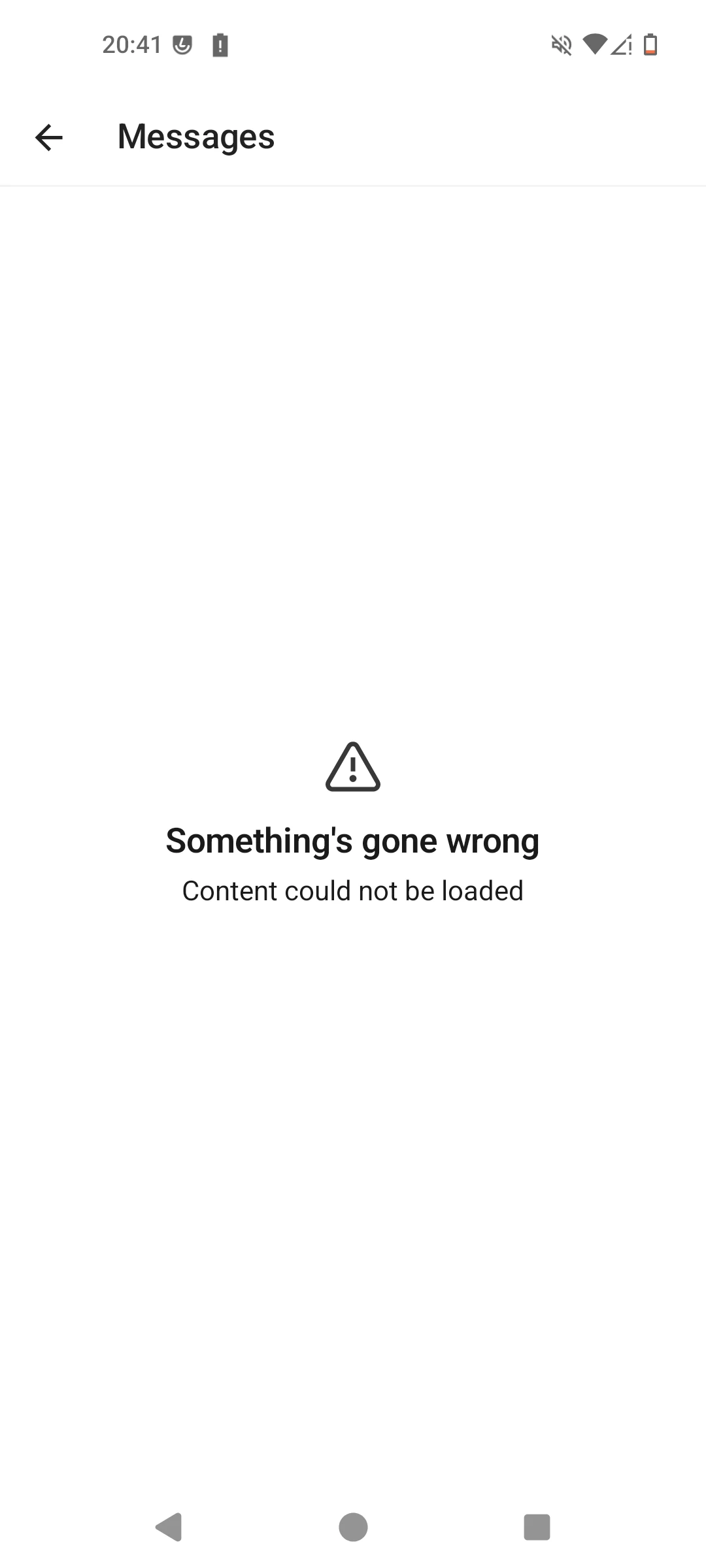

We are using Intercom React Native 7.1.0 (Intercom Android 15.8.+) with iOS working fine except for Android. and it keeps crashing.
“Something Went Wrong”
“Content Cannot Be Loaded”
This has been happening for a long time, this doesn’t happen on iOS or the Web.
I have tried this solution:
We already have this option enabled, and still doesn’t work.
I don’t know what is causing this issue as we already have loginUserWithAttributes() in our app and iOS is not breaking with this error message either.
We use it like this in our code:
await Intercom.setUserHash(user_hash);
await Intercom.loginUserWithUserAttributes({
email: user_email,
userId: uid,
We want to support lower versions of users on iOS and Android so upgrading is a not an option.
Is there a way we can resolve this.

Solved! We had to add the following rules to our proguard file:
-keep class io.ably.** { *; }
-dontwarn io.ably.**
-keep class org.msgpack.** { *; }
-dontwarn org.msgpack.**
-keepclassmembers class * {
@org.msgpack.** <fields>;
@org.msgpack.** <methods>;

We have our React Native app on production using v8.5.0. Since two days ago (the exact date you released v9.3.2), it's been crashing on Android when users open the Intercom screen, with the following error:
Caused by java.lang.RuntimeException
java.lang.ClassNotFoundException: org.msgpack.core.buffer.MessageBufferU
It seems you broke something retroactively. I need your help, as the Intercom support on our production app has stopped working suddenly.

Intercom Android SDK Version: 17.3.1 -- Did not work without upgrading the React Native version.
I would like Intercom to do a backport of the fix you have to Intercom React Native 7.1.0 so that we shouldn’t have to upgrade React Native entirely. This was actually working without us doing anything and now it is broken without any notice from Intercom.
This is frustrating as we didn’t do anything and it is causing and forcing our engineering team to have to make a whole new upgrade to our entire app.
Can you please help out here with this regression in Intercom?
