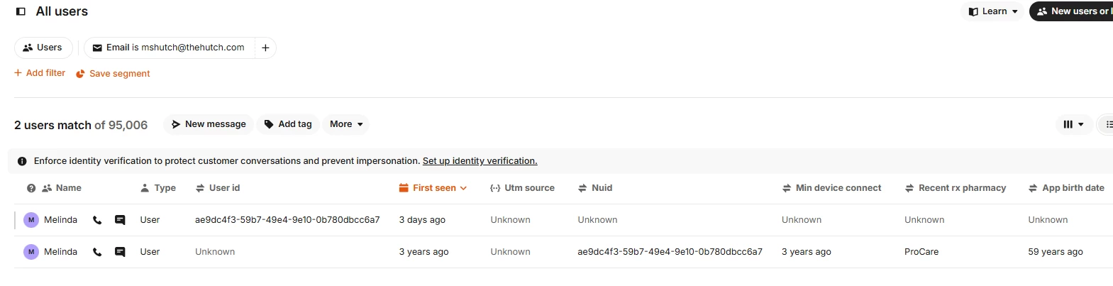

We are experiencing duplicates creation on intercom for the same userIds and emails, the example is below:
I think that the problem is on SDK side or/and API calls to Intercom.
For example, to update existing user we do a post request to search by email intercom id and update that contact, but it looks like sometimes (event if a user exists on Intercom ) by some reason we are not always getting intercom id back and then the script creates "a new contact"  (or it is something within SDK). The issue is that it is not a new contact and it should not work like that. Eventually these duplicated users go to "onboarding" series, but they are old and should not get any onboarding emails..

Hi,
What could be the issue and solve it? Maybe it is about API/SDK update?...
