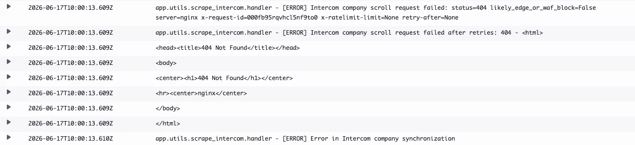

We're hitting intermittent errors from the REST API that appear out of the blue — not correlated with our request rate or any code change on our side — and that succeed when we retry a short while later.
The responses come back as HTML (nginx), not the usual JSON. Two examples:
  • 404 Not Found — GET /companies/scroll, x-request-id: 000fb95rqvhcl5nf9to0
  • 403 Forbidden — seen previously (HTML, no x-request-id / x-ratelimit-limit headers)
We've increased our retry/backoff, which recovers most occurrences, but some still fail outright.

Any help here would be pretty appreciated. Happy to share timestamps and more request IDs.
